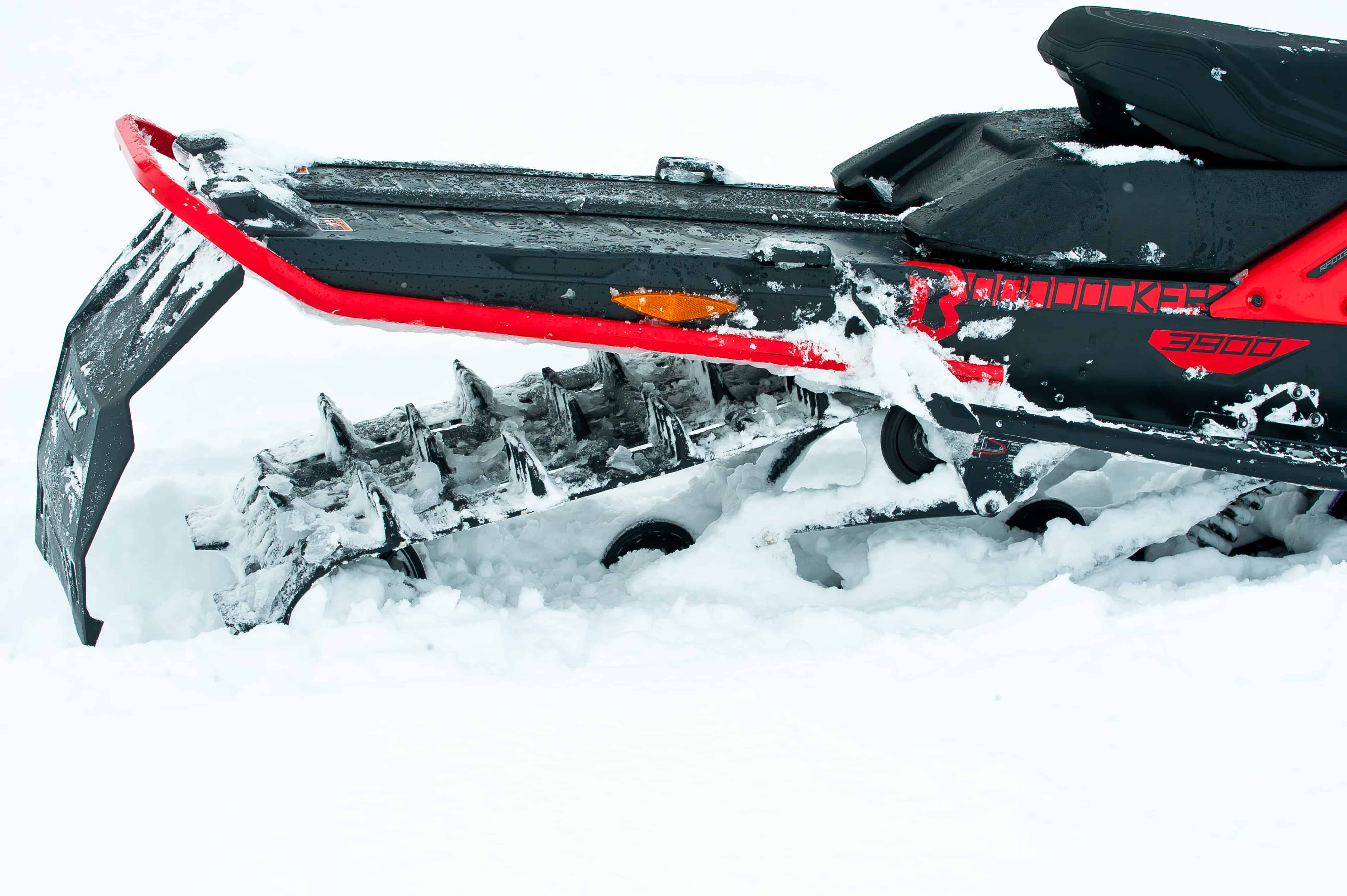

 Lynx BoonDocker RE kommer att vara utrustade med PPS²-3700- och 3900-boggi. Den största skillnaden jämfört med PPS²-DS boggin är koppling i främre svingen. Den bakre upphängningen är densamma som användes på 2018 BoonDocker RE 3700 850.

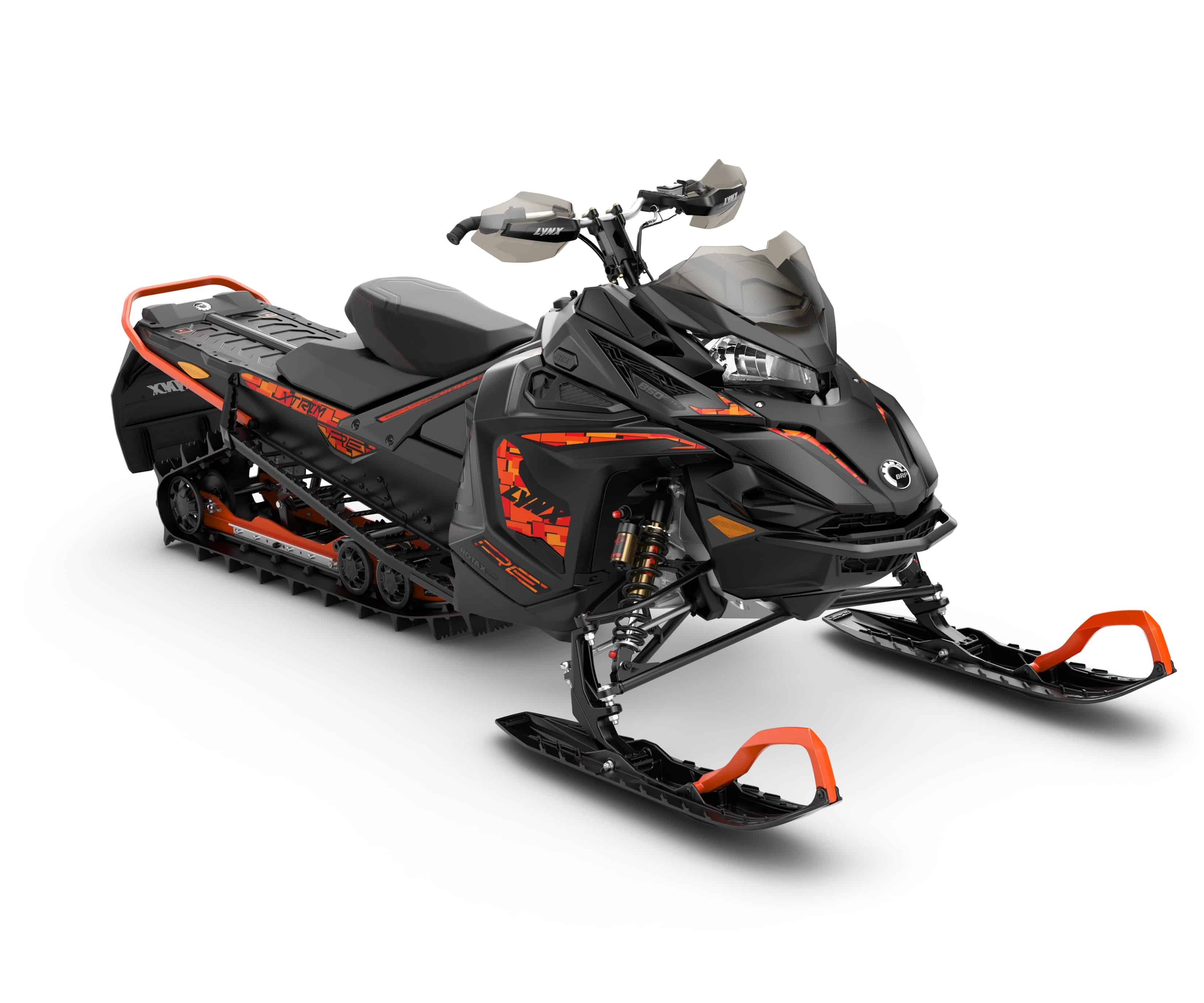

Boggiinställningarna för Xtrim RE 850 förbättras avsevärt för modellåret 2019. Fjädringen har ändrats på två sätt:
- Placering av boggin i tunneln
- Förändrad fästpunkt för främre sving i “ramen”. Fästpunkten flyttad uppåt och bakåt
- Bakre boggidämpare flyttad. Byte av position innebär mer kontrollerad viktförskjutning vid acceleration
- NY kalibrering av RE-fjädring

Lynx BoonDocker RE snowmobiles will be equipped with PPS²-3700 and 3900 rear suspension. The biggest difference compared to PPS²-DS rear suspension is linkage in front arm. The rear suspension is the same that was used on 2018 BoonDocker RE 3700 850 model.
Reason for the lastminute change was the fact that the old configuration was still a better performing solution. We were not 100% happy with PPS²-DS and KYB 46 HLCR shock combination.
The decision to go forward with the already proven rear suspension was made to ensure a consistent riding experience.

Rear suspension settings of Xtrim RE 850 snowmobiles is greatly improved for model year 2019. The suspension has been changed in two ways:
- Rear suspension positioning
- Re-located front arm attachment point on frame. Attachment point is located upward and backward
- Rear shock is in new position. Change in rear shock’s position means more controlled weight transfer when accelerating
The result is better controlled weight transfer when accelerating or when braking. Changes in suspension geometry and positioning reduce tendency for un-wanted wheelies. Playful characteristics of Xtrim RE is still there and enjoying the performance is easier than before.
- NEW RE suspension calibrations
Xtrim RE 850 snowmobiles share the same suspension calibrations as all the other models with RE package.
New suspension calibrations are made for aggressive riding on bumpy trails. The calibrations are sportier and the operating window of suspension is bigger, which provides more stability and comfort in all riding situations and environments.

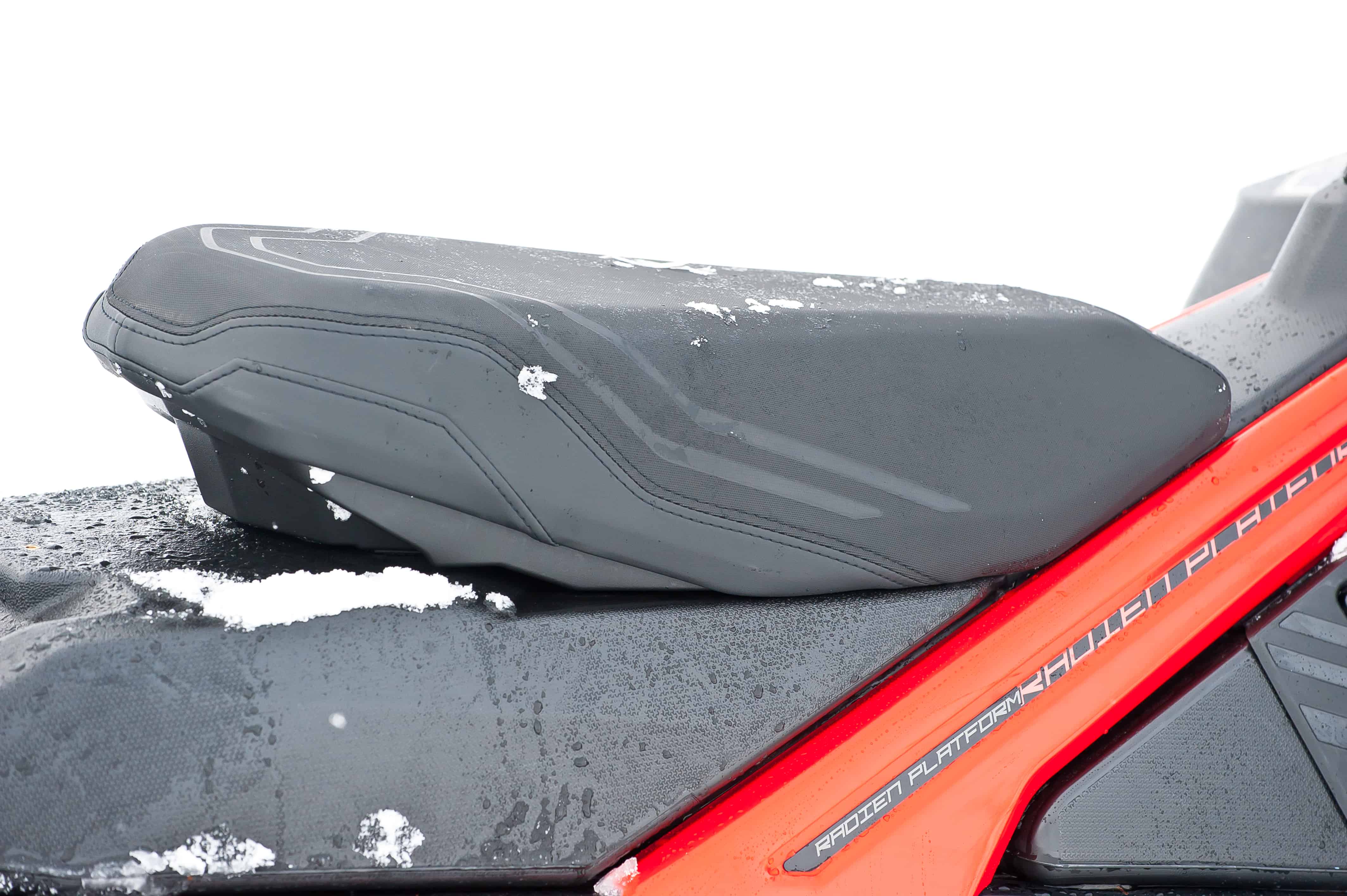

All Lynx snowmobiles with RADIEN chassis will get new, firmer seat foam. New seat foam gives better support and longer seat life. It improves riding ergonomics by providing firmer support which allows for less sagging and shallower knee angle.
The new foam composition also increases the shock absorbing capacity of the seat.
